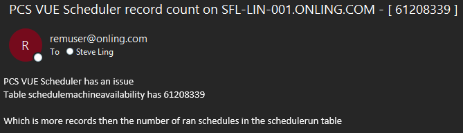

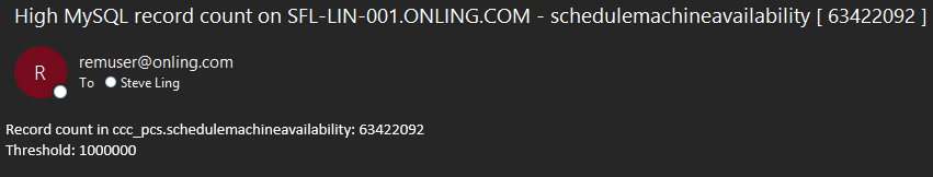

It will send something like this for PCS

# Check threshold and send alert if exceeded
if [ "$record_count" -gt "$threshold" ]; then
body="Record count in $MYSQL_PCS_DATABASE.$table: $record_count\nThreshold: $threshold"
send_alert "High MySQL record count on $HOSTNAME - $table [ $record_count ]" "$body"
fi

if [ "$mysql_pcs_record_count" -gt "$MYSQL_PCS_RECORD_THRESHOLD" ]; then
body="PCS VUE Scheduler has an issue\nTable schedulemachineavailability has $mysql_pcs_record_count\n\nWhich is more records then the number of ran schedules in the schedulerun table"
send_alert "PCS VUE Scheduler record count on $HOSTNAME - [ $mysql_pcs_record_count ]" "$body"
