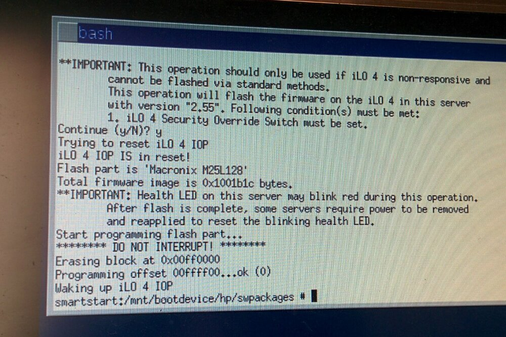

Turn off the power, remove the case. On the system board, find the main dip switch (System maintenance switch) and turn the first (S1) switch to the ON position
Load the server from the SPP flash drive
Once on the image screen you need to select Interactive mode and when the main menu loads very slowly
press ctrl + alt + d + b + x to launch the console
Run:
You need to enter a simple magic command:
rmmod hpilo
then Run:
sh /mnt/bootdevice/hp/swpackages/CP027578.scexe --direct
After successful iLO flashing, turn off the power and return the first (S1) switch back (OFF).
